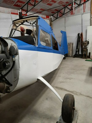

Anyone know about this "7KCAB Project" on Ebay listed today?
eBay item number:
275054899932
Looks like a lot of work has been done, but a ton of work still needs finishing.
Any input?

EBay is strange - folks often offer things at triple their market value, and once in a while folks bite.
$72 grand should get a well-equipped, drop-dead gorgeous 7KCAB with recent zero time engine or factory reman, new interior and really good avionics. Maybe I am out of touch with prices lately?
i would be approach everything there with extreme skepticism. a zero time field overhauled engine that has been sitting for twenty years has a name, it's called "core"! lol wood spar wings with fabric that keeps you from really inspecting them, fabric by someone that didn't finish it, it's a box of red flags for a price that is three or four times what it should be.
That plane (project) is listed on Barnstormers for $19,500.
That's a bit more reasonable.
I don't think it is necessarily a hard pass, if you have the skills and circumstances to finish it right and manage the sign-off process. Borescope the engine to look for evidence of corrosion, and pull out the interior and floorboards to get a close look at the fuselage tubes. Plan on a pre-emptive tear down and IRAN on the engine, and cut a bunch of inspection holes in the wing to really give the spar a close look.
Someone needs to go to the effort to get this one flying again. Plane Lives Matter.
Agree. $20 grand is about right for an undamaged Citabria or Decathlon disassembled, assuming title is clear and no pieces are missing. Not sure having new stuff or overhaul makes that much difference unless the overhaul was done by a serious engine shop.
if the engine is sound, what is the additional cost to make an overhaul of an IRAN? overhaul resets the clock, IRAN leaves the original overhaul date in the books. just wondering
IRAN unless I’m wrong, this can be as little as a new set of gaskets assuming nothing is found out of service limits. So your out gasket set and labor. As for a overhaul there is a required list of items to be replaced with new, even then you have a field overhaul, not a zero time motor. I did a major overhaul on my Warrior with all new cylinders kits from Lycoming, new cam, new crankshaft (that’s a story in itself) all new bearings but not new accessories other than sure fly mag. Still I had about $12.000 or so in materials without labor. That included all the machine shop parts for serviceable tags. Still I carry total time and TSMO in logs.

Except a knowledgable purchaser would see who did the IRAN, and then have the confidence that all was well as of that date.
Still, 20 is ok; 80 is for the sucker born every minute.
