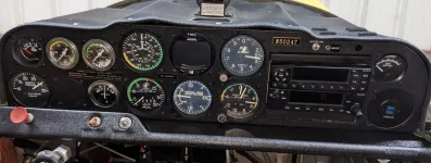

For starters, here are some picks of the airplane in happier times.
PXL_20201002_182821691 (8).jpgPXL_20201003_181459785_2 (1).jpgPXL_20201003_181459785 (1).jpgPXL_20201117_220310840.jpgPXL_20201118_011503019.NIGHT (2).jpgoriginal_e66a4f7b-ccf1-4649-892f-26e89ec3e646_PXL_20210314_001800051.jpgPXL_20210726_151108980.jpgPXL_20210726_232347708 (2).jpgPXL_20210801_213503982.jpgPXL_20210917_025327600 (1).jpgimage.jpgPXL_20220410_174210167 (1).jpg
