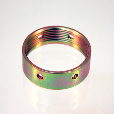

Is this what your looking at??
Yup! Except mine looks like this:
Here's the info from my Citabria manual. Looks like #12 (1-706) is the nut you're looking for. Other components including hub caps are also depicted if you're wanting to go all out but I wouldn't know about their availability. I'll bet Chad at ACA can fix you up. Personally, I also just run the cylindrical nuts that go with the pants.IMG_9864.webpIMG_9865.webpIMG_9866.webp
