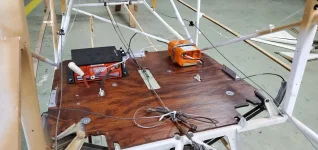

Here are pics of the 680 install behind the seat of the Champ. The box is specifically for the 680/sbs-j16 battery. I'd be willing to bet a field approval for the AMOC wouldn't be too hard...
As long as the steel Odyssey battery box is solidly mounted to the same structural members as the old box there ain't much difference.
