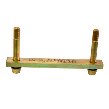

image.webpimage.webpimage.webpimage.webpShould be easy to change hope this helps. You still need the two inside bolts I just couldn’t put my hands on then right now. I’ll search some more later to see if I have the part numbers.
Replacing the inside bolts is not part of the mod - but it does relieve you of the non-mandatory 50 hour torque check.
