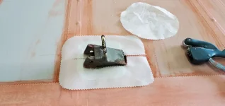

Just curious if there's any consensus opinion out there about Ceconite vs Superflite tapes. I was running low and ordered Ceconite 102 2" straight tape from Aircraftspruce but when I went to use it it was different and didn't seem as easy to use as the stuff I had been using which came from ACA.
Chad said they use Superflite, straight pre-shrunk 102 tapes. I thought they were technically the same but I like the Superflite tape better.
Am I crazy? :yesss:
Well, the edges of the Superflite tape seem to lay down more naturally and the tape seems to wipe clean of the adhesive more easily. The Ceconite tape edges have to be ironed down and even then they seem to have an edge to them. Maybe it's the way they cut the straight tapes? idk
Both are straight, 102 weight tapes. The Superflite tape is pre-shrunk, I don't think the Ceconite tape is pre-shrunk. When I touched the edge of a Ceconite tape with a 250 degree iron today it sucked the edge in pretty quickly. :mad: I was trying to see if the edge would lay flat with a little extra heat since 225 degrees didn't do it.
If I had to guess, I'm thinking maybe they cut the Ceconite tape with a hot tool of some sort. When I tried cutting reinforcement patches (see what I did there?) with a 700 degree soldering iron, the material had an edge along the cut line that wouldn't lay flat. Just a guess.
The Superflite fabric and tapes have a finer weave than the Polyfiber fabric and as such will definitely react differently to paints, glues and how well they attach to the underlying surface.
When you write "straight" tape I was assuming you were talking about straight vs. Bias tape. The straight tapes are for straight runs and bias tapes are made to go around curves and corners...
I see now what you are calling "straight" 102 tapes are actually non-pinked edge tapes. Is there a reason you aren't you using pinked edge tapes? Is this an ACA thing?
Yes, ACA uses straight tapes at the factory. The fabric detail drawing shows pinked or straight tapes and I just used straight to keep with the new plane look I guess. Remember, I'm crazy. lol
But you can see in the pics how the edges look different, right? It more pronounced in person
Don’t know why, but I see way more non-pinked tapes pulling up.
A non-pinked tape has no resistance torsionally. Much like paper or cardboard a straight tear ontinues until it comes to a place where the tear can't continue. A straight edge tape will easily peel back until it has to change direction. Also, a pinked 45° edge has close to double the gluing area of an equal length straight tape. Back in the day (dope) the tapes were covered with 6-8 coats of paint and weren't expected to last 20 years.
If you're liking the straight tape look and it's working for you then by all means continue. But, having done a few covering and repair jobs over the years the difference in the straight tapes vs. pinked tapes is night and day...both in ease of application and longevity.!
Chris (who has never been a fan of the factory cover and paint...)

OK, let’s set the record straight. During WWI, the edges of aircraft tapes were unravelled by hand to leave a crude fringe. The idea was to give a nice transition from fabric to threads to promote adhesion when they were doped in place. But unravelling the edges of the tapes was a real pain and it took a lot of time. So they got smarter and figured that if tapes were cut with pinked edges, you get the same good adhesion with less labor. Pinking also kept the cotton from unravelling. So pinked tapes came into vogue in the twenties. Straight-edge tapes came only with the introduction of polyester fabrics. Since polyester could be heat slit, it was an easy way to make a tape. The problem with straight-edge polyester tapes is the ridge formed at the edge when they’re heat slit. That ridge gives no transition to the tape and, in fact, promotes peeling over the years. Pinked tapes have 41% more edge area to help adhesion. They’re cut with a knife that leaves no ridge and, by golly, they are historically correct.

Having the proper tools helps the process of taping and reinforcing patches (following the moderators lead here) go smoother and makes attaining a nice finished product easier.
My must haves were always:
Good FABRIC shears. Not scissors, shears! The tip of a good fabric shear will cut a single piece of thread without having to even hold onto the thread. It will cut fabric cleanly without damaging the fabric edge.
Next is a rotary Florian pinking shear. You can make any shape piece of fabric easily...round inspection ring doilies, strut opening reinforcement, etc. Last but not least is a good pinking shear for long straight cuts.
Having at least the Fabric shears and the pinking shear are what I consider mandatory...the rotary pinker is simply nice to have.

Just to keep the fabric knowledge flowing, which I happen to find really interesting, here's what Stewart Systems says about fabrics. I definitely noticed that the Superflite tape lets you adjust your line left or right as you go where the Ceconite tape has to be dead on from the start. If you try to adjust the Ceconite tape it lifts on the side you're adjusting to and has to be ironed down when it's dry.
Stewart Systems is certified for use with all certified Dacron/Polyester aircraft fabric. Currently there are three brand names of Dacron/Polyester aircraft fabric available: Superflite, Ceconite, and PolyFiber. All of the technical specifications for Ceconite and PolyFiber are identical and they are produced by the same company, Consolidated Coatings. For our purposes, Ceconite and PolyFiber are identical, therefore out of those two, we only carry Ceconite.
The main difference between Ceconite and Superflite is the thread count in the weave. Superflite 102 fabric has a higher thread count and therefore a finer weave and is a little lighter. This allows Superflite fabric to be worked around curves and tight areas easier. Ceconite has a lower thread count and is a little heavier and therefore has a stiffer characteristic. Some people like this because it will lay straighter on a large area such as a wing or fuselage, and it has a stiffer feel when complete. In general, we prefer Superflite fabric.
