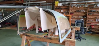

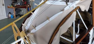

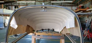

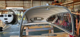

I don't know if any of these photos in this link would help.
I don't have any photos from my files of that area, it's not something I normally think about to shoot.
I do know that the part no. for the windshield upper support is 3-549 and is .032 aluminum and 23" long, sorry I can't read the width on the drawing.
On my 7AC it had the upper support and inside the windshield I believe maybe, there was a 90 degree piece of aluminum across the width just under the upper support . The fabric was wrapped over the front wood former a bit and stapled, then the headliner was also stapled to that same former. You could cover it all up with a painted piece of aluminum.
If I find anything else I'll let you know.
Headliner Install Photos | ChampCitabriaDecathlonForums
Okay, I just found this photo and this blog, scroll through to see if any other photos help.

so you start by mostly installing the headliner and then do the fuselage fabric, and then finish the headliner before installing the greenhouse glass?
Bill noted he doesn't have a skylight my description pertains to attaching the fabric to the front of the cabin top/spar carry-thur...
Actually, IMO if you attach the headliner to the two top tubes that go from the rear spar carry-thur to the tubing cluster prior to covering all the other places the headliner attaches to are easy to get at no matter what airframe you've got...
gotcha and thanks for the explanation. is that a wool headliner?
Yep. Airtex Tan wool. Easy to work with and if you do have any slightly loose spots when you're done a spritz of water and a couple of passes with a hair dryer* will shrink out any wrinkles...
