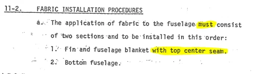

Factory service manual for 72-79 Bellanca Decathlon:
I believe Bart has posted the ACA covering process elsewhere on this forum, and it has the same specification.
