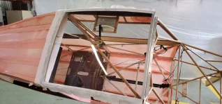

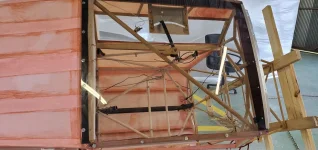

I am fitting the rear greenhouse attach pieces before covering on my Decathlon. From your previous posts, I guess the fabric goes over both of those pieces and wraps around the front piece that holds the rear of the greenhouse glass in? Is that where a person uses that special contact cement?
Also, at the front of the greenhouse, the parts book seems to show the top piece that holds the back of the windshield and the front of the greenhouse glass with the holes facing toward the tail. Is that correct? It seems like the holes should be facing forward.

The two pieces in the front face opposite directions. The one facing aft holds the greenhouse plexi between itself and the front wood former. The one facing forward sits about 1/8" lower and is where the top of the windshield attaches. The rear aluminum piece mounts to the aft side of the rear wood former. The plexi sits in the depression (after the top fuselage covering is attached) and captures the fabric between the aluminum and the plexi. Fabric then goes across the whole thing to make a smooth transition...it's this fabric strip that comes loose in the slipstream.
Front 2 pieces
Rear transition
The black rubber strip is a seal I put under the rear of the plexi.
Hope this helps...

Thanks, this helps me. I was thinking that I needed to use two metal strips aft to attach the plexi. The pictures make sense to me.
Would you suggest that I use the ACA contact cement on the tape or just use the fabric cement that I use on the other tapes?

I use the Poly Tac fabric glue with good results myself but others use the contact cement like the factory. Either works.
A word to the wise; if you use the contact cement get a helper to assist on the rear fabric strip; it's a long piece and hard to keep straight. And once the two sides touch its stuck for good, straight or crooked...
Thanks Chris! I'm mounting the front and rear attach brackets so I can get the stringers moving and wanted to put a spacer in at the front for the greeenhouse panel like Chuck did. Appreciate it!
The factory specifies contact cement for all fabric attachment. I think it is overkill. The solution is an STC process - Stits or Ceconite. Then you just use the universal Super Seam cement and it becomes a major alteration, not a major repair.
