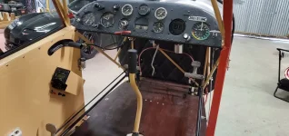

There is a guy on Ebay that makes really nice reproductions of Aeronca placards. I used several of them during my resto-mod...
Right hand side above airspeed indicator.
