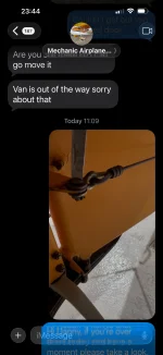

Manual says PN# AN 115-16
Aircraft Spruce has AN 115-8 and 115-21
I want to do the whole assembly bolt, washer, nut, clevis pin.
Can someone please make it easy for me?
Thanks in advance.
Bolts wear out, but the thimbles seem to last a long time. Are your thimble holes elongated?
If so, probably your rudder holes are, as well.
Aircraft Spruce doesn’t have every single part you might need, you have to look around sometimes, google the part number and see what pops up
And, like Bob said, have your A&P inspect everything in that assembly for wear while it’s apart.
