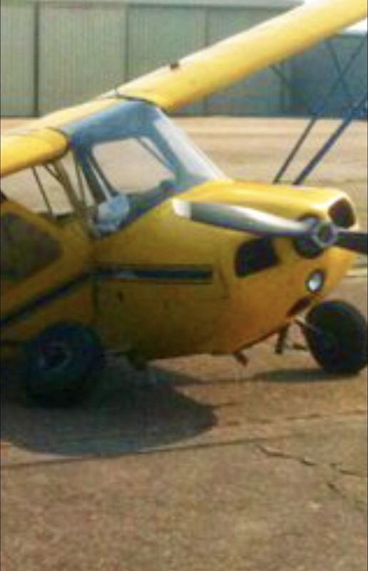

Reminds me of this
Was taxing out and it just felt like a stick snapped under my butt
One of the bolts finally gave way, thankfully it was on taxi and not on takeoff or landing
Another spring gear failure
Totaled the plane?!!!
Also very shocking to see the leg just clean snap like that, wonder if they ever did a metallurgy analysis, intergranular corrosion?
In my photo, I recall the prop got hit but not enough to notice from inside, we shut the ending down and didn’t even know it touched till we looked at the prop, no engine damage as I recall, think it was new gear bolts, fabric patch, prop and inspection.
I'm wondering about the heat treatment that leg received and whether it was part of a batch. It's original certification shows as march 69.
