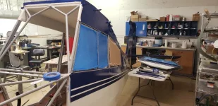

I have been working on windows and we are keeping the slider look

Looking good what year is this I may have missed that here is the beacon from outside on 79 not sure if this helps hauling it home now as for missing firewall forward which motor u going with? When I get home I can take more pictures and be more help.
Keep going and where you located

Hi Bruce, the year of my Citabria is a 65. What I'm looking for are any pictures of how the strobe mounts to the fuselage or the frame.
