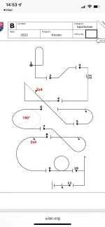

Uggh. Final Sportsman Sequence came out. IMO they took a very good proposed sequence and made it worse. The Split S with 2/4 roll is questionable in a Decathlon or Citabria. Definitely going to have to come off on power now.
I'm not sure why they changed the proposed. Slow roll after the immelmann too hard with a Citabria? I've no Citabria time, anyone here do that?
But easily flyable by a Super Decathlon, challenging for a first-timer because of the length if nothing else. Still a big fan of starting with Primary. Still not a fan of 11 figures without wind correction- that would have been a good reason to revise it.

I know the guy who test flies the proposed sequences. Adam Cope. He's a solid guy with about 30 years of instructing experience in Decathlons. So I'll give him the benefit of the doubt. I pinged him on Facebook to get his tips. Will post response if I get one.
I had no problem at all with the slow roll after the Immelman. I prefer rolls at slow speed in my older Super D, because stick forces are less. I HATE the current approach of a roll at the end, after a Hammerhead. However, I do want to find out whether downline on the HH has a length criteria. If not, then I can pull early to do the roll at optimal airspeed.

No length requirement on hh downline other than judges need to see a line. Short line will keep speed down, make it aggressive pull and you’ll bleed more off. Almost judges school season, btw, check iac website.
Finally got up and tried the Immelman - 2/4 Split S combo. I will issue a qualified retraction. It's not particularly difficult to fly. However, I came off power as I hit inverted and started the pull. Even then, I was smoking fast at the bottom, and pulling just shy of 5G. So I'm not a big fan. Maybe my irritation will soften when I fly it more and get into the nuances.
