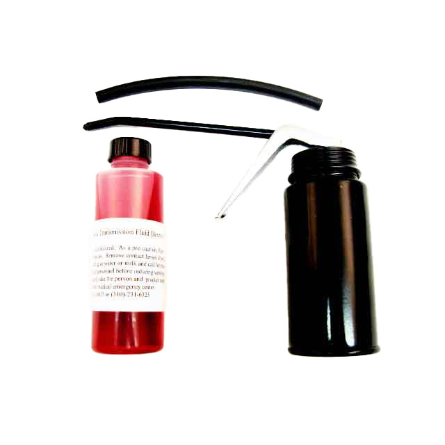

something along these lines

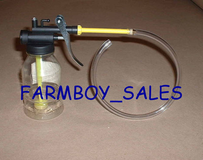

Spruce sells this, but the price is absurd. Dunno if that style pump is less susceptible to bubbles or something. My A&P loaned me one the first time I did my brakes. No bubbles but pumped REALLY slowly. After that I grabbed an oil can from Ace Hardware.
They don't make good pumps any more. You are looking for an all-metal can with a non-flimsy pump and lever. Balkamp, among others, made tons of them. No more; they are plastic and the pump lever will bend.
That syringe won't hold nearly enough fluid.
I personally haven’t used this small one but one guy on the field talked my ear off about it. We use a lot bigger setup. Modified the second link with a ball valve and such. Only way to get enough flow for the notorious air tractor brakes.
