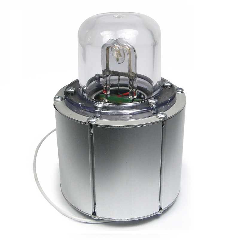

I'm ready to replace the original rotating beacon on my 79 GCBC with a non-rotating LED replacement that flashes versus a motorized rotating one. I believe I have heard there is a replacement option that fits perfectly where the old rotating model is mounted. Does anyone have a part number/name/model? Thanks
Check part numbers like SPL-400 or equivalent LED aviation beacons.
This isn’t LED but is a hell of a lot cheaper.
I’ve got one. Required a 337 but it mounts right up to the old holes. Just a paperwork exercise.
