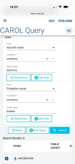

Did a quick search on CAROL, went off “Aeronca” and the cause had the word “brakes” in it
Seems the cause of these events has been too much brakes, not too little
