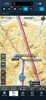

Whelp, I determined my glide ratio today. Yikes, I came up with 7 to 1. 75 mph best glide speed yielded 925 fpm. I plugged it into ForeFlight, used their fancy glide ring, and sure enough I successfully glided to an airport.
