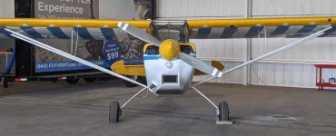

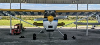

Here are before and after pictures of mine from 6 months ago. Look closely at the camber (inward tilt of top of wheel) on the starboard wheel.
Also included is a pic of the new landing gear bar bolts. Definitely want to upgrade those if you still have the old U bolts.
PXL_20210115_181058546 (2).webpPXL_20210309_200419934 (3).webpPXL_20210220_004254761 (4).webp
