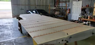

I had the right wing ready to start attaching the fabric this afternoon. Placed all the rivets on the bottom side...20 minutes later it was ready for taping...🥳🥳🥳
It would have taken hours to do the washer/pk screw attachment and then you have the problem of them coming loose from the rib.
An Aeronca porcupine.
20 minutes later.
Rivets taped...

A quick update. All the covering is on, still have the tailfeathers and ailerons to tape and polybrush.

All parts skinned
20 miles of masking tape

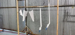

Polybrush sprayed
Polyspray sprayed
A wee bit of sanding and I'll shoot the last coat of silver...
With luck I'll get the white Polytone basecoat done this week and be ready to shoot the Red and White Aerothane next week...

Got the last coat of Polyspray silver on and checked for any problem areas.
Waited a few days to let the solvents wick off and sprayed the White Polytone basecoat.
Monday I'll hopefully get it taped up and get the White Aerothane shot. Then re-tape and shoot the whole thing Aerothane Christian Eagle Red...🤗🤗🤗.

Next up:
Polybrush and Polyspray for the flippers and such.
While waiting for everything to dry I'm also lining up all the small stuff to prime and paint...
