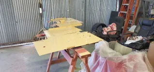

The right (starboard for you rust pickers) wing went into the booth and got Polysprayed, white undercoat of Polytone then Red and White Aerothane...
When I shot the white panels on the wing I also shot the rudder. One more wing to do up from the Polybrush coat and I'll have all the big pieces done.
Polybrush sprayed coats.
Polytone White undercoat.
Aerothane white and red.

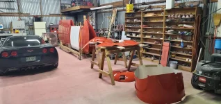

Finished all the interior panels this morning...
This afternoon it was time to tear down the paint booth inside the hangar and clean (most) of the debris away.
Damn it was good to have all that space back!
Everything is painted...there are a few spots I'm not happy with but WTH...and as my wife opined; ..."that's a lot of RED...!

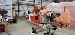

I've made lots of progress reassembling the Champ in the last couple of weeks but I was forced to re-think my vinyl Maltese Crosses...the guy who said he would do them for me kept putting me off and when he finally DID come to the hangar to quote the job the price was ridiculous.
So I'm back to painting them on...so much for trying to save time. 😳
Anyway; the interior panels are in, the electrical system (such as it is) is in and tested, radio and intercom are all ready to go.
The engine was de-pickled (un-pickled?), prop was put on, gas in the tank, oil in the sump and she fired right up! As I didn't have the windshield on yet I kept the rev's low so as not to test the burst pressure of my new headliner material...
I'm hoping to get it in the air by the first week in April if the weather cooperates for the paint and the paperwork is finished...

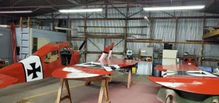

OK,
I got my Maltese Crosses all drawn up and cut out my templates. I was originally going with 22" Crosses on both the fuselage sides and the fin/rudder but I didn't like the way that looked after mocking it up so I resized the rudder cross to 18".
Anyway, I got the crosses marked out and started taping.
After the crosses and stripes were laid out I draped the whole fuselage (this was quite un-fun) and got ready to shoot the fuselage trim...
Of course everything in the hangar had to be covered up as my paint booth was in the recycling bin...🤬🤬🤬.
Two coats of Black paint later I had the fuselage of my Aeronca Eindecker VIII done!
I finished the wing crosses this afternoon so, barring me doing something stupid the painting is done...
The last big project is, of course, getting the wings attached. Then the rigging, weight and balance and final checks and adjustments and it'll be a real airplane for the first time in 11 years...
BTW; I kept the original N-number...after 75 years I didn't have the heart to change it. She'll fly as 82558. Again.

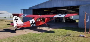

I pinged a few friends and asked for strong backs and weak minds to meet me at my hangar this afternoon for a work detail. Great bunch of guys from our local EAA chapter and a couple others showed up to help me get the wings attached.
I had the wings, struts and hardware all layed out as well as a wing-sling, alignment bars and a small persuader (hammer). Start to finish less than an hour...I kept waiting for something to go wrong but everything went great.
I'd forgotten how big a Champ is (wingspan wise). 😃
Waiting for the troops.
Everything fit!
Snoopy likes his new ride.
Warbird parking at Fly-in's?
Still have a week or so of work to do but today was a big step...

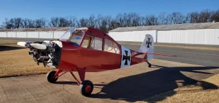

Well shes actually finished!
I got all the small jobs and changes done last week...l got my scuff plates under each rudder pedal put on, new sliding window latchs made and installed and even put the covers on the vertical tubes that will keep the tubes from looking shopworn after 50 hours or so...
a few minutes later
Weight came in at 894lbs. with the CG 1/2" forward of the original balance point...it's 15lbs. heavier than I wanted but I do have the C-85-12 with a starter, a metal prop, a battery, two 5.5 gallon aux tanks and the radio and ELT. So with the Pancake STC raising the gross to 1320lbs. there's still a fuzz over 400 useful (legally).
Working on the paperwork this week so maybe it'll fly sometime in April.
I received the last piece of the puzzle that was the Grove toe brake installation on my Aeronca yesterday, an Official FAA Engineering Approval... so after I get the 337's done I'll have the same braking system on my 1946 bird as the 2005-2016 7EC using the same TSO'ed Grove components...
With a total of 11 337's and 7 STC's plus the logbooks and other required Aircraft Paperwork my typing finger(s) are worn to a frazzle...but N82558 should return to the sky sometime this coming week.
