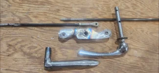

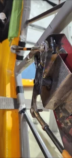

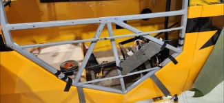

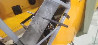

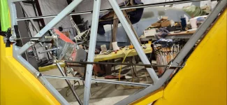

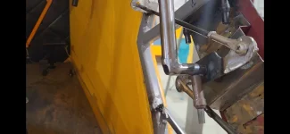

Got the inside handle fabbed and the outside handle set up today... I ran a mig bead on the shaft and ground it to fit one of the corners on the stock square cavity handle (likely a 40's vintage off the shelf ford) then I drilled the shaft for to match the roll pin holes in the stock handle.
I used a piece of 4130 round tube to build the inside handle and pinned it too.

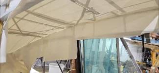

We took the headliner out of the box today and clamped it up today... things will get sticky Monday.
What have you guys done to make allowance for the rear shoulder strap?

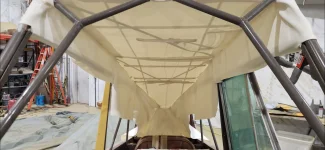

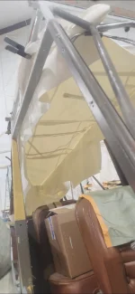

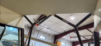

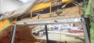

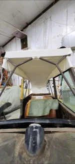

Yesterday I put in 6 hours on the headliner. I got the forward half of the cabin covered.
How much time did it take for those of you that have installed them?
I’ve only done one and it was slow going. It’s a weird process, not like other stuff unless you do a lot of upholstery so just take your time and it’ll be nice.

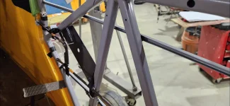

Its my third rodeo with the headliner demon. Total time was about 11 hours not including the shoulder harness backer through plate. PIA, but its a challenge i dont mind.Screenshot_20260318_150300_Gallery.webpScreenshot_20260318_150305_Gallery.webpScreenshot_20260318_150313_Gallery.webpScreenshot_20260318_152405_Gallery.webpScreenshot_20260318_202519_Gallery.webpScreenshot_20260318_202524_Gallery.webp

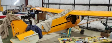

Swapped out the tailwhel steering springs with compression style springs. I like the little bit of slack at center that lets the tailwheel be when the rudder is straight. My IA friend said we'll include it with the other work being done for the annual when we make the entry. I'm not sure when the annual will be done and I'll have a chance to try it.
View attachment 9315View attachment 9316
I have the same size springs on mine. At least with my setup, you need to leg press the pedals on the ground if you are even remotely near max gross. I like them when you're landing on taking off as it forces you to make small movements, but they are a bear to taxi with. My plane is a bit tail heavy so I'm sure that adds to it. Looking to change them out for lighter compression springs, my friend's Husky has ones about half the size.
please post a link to a new thread if you find out where his springs came from. The ones in the pic came from Aircraft Spruce, they were about $55 for the set.
