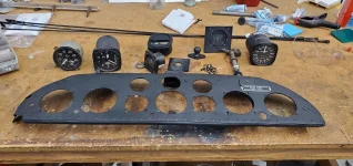

You need an aluminum sheet - .080 seems to work - and a fly cutter. Caution on the fly cutter; you need to clamp the aluminum to the drill press securely and keep your hands out of there. And wear eye protection.
I have done my Dec (page 1 above), a Mooney, and four Piper Cubs. The layout for standard instruments is really easy.
I am sure CadCam would make short work of it, but the time spent on programming and setup would be more than just cutting one panel.
